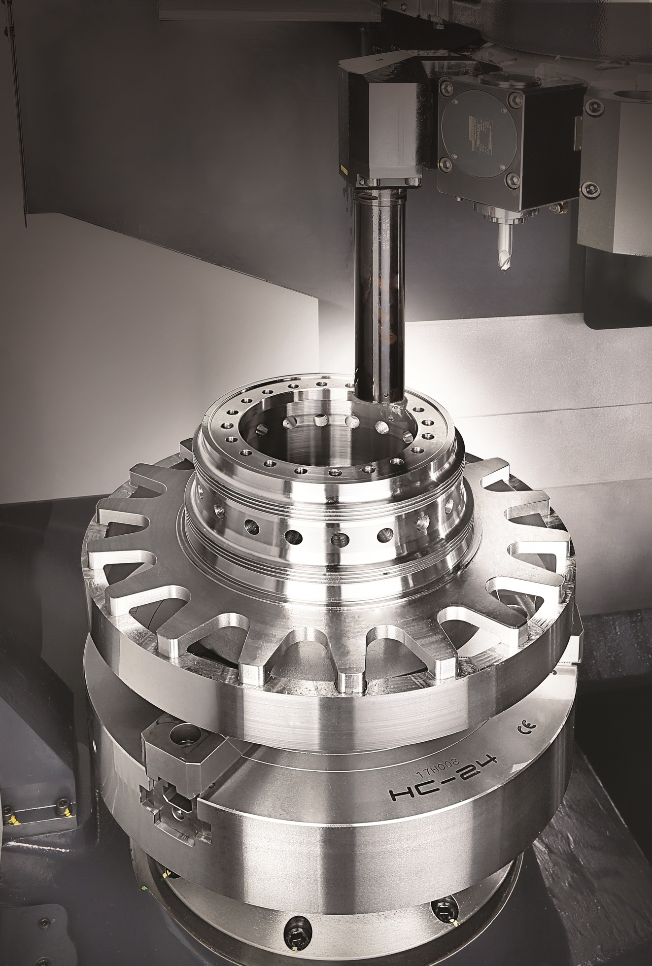

The PV6300 series is a high-productivity vertical turning center developed with DN Solutions’ latest VTC technology. It features an integrated column box guide structure and a reinforced bed frame, providing a rigid construction capable of withstanding heavy-duty cutting. With the highest machining capacity in its class, it offers customers enhanced versatility in operation.
￿ Large Work Zone
Max. chuck size: 18inch
Max. turning diameter of 630mm
￿ Maximum Machining Capability in its Class
Spindle motor: 37kW, torque: 1638N·m
Equipped with a high-reliability servo-driven turret to maintain high accuracy even during long machining operations
Increased turret disc thickness enables more powerful cutting

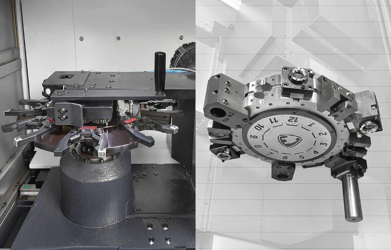

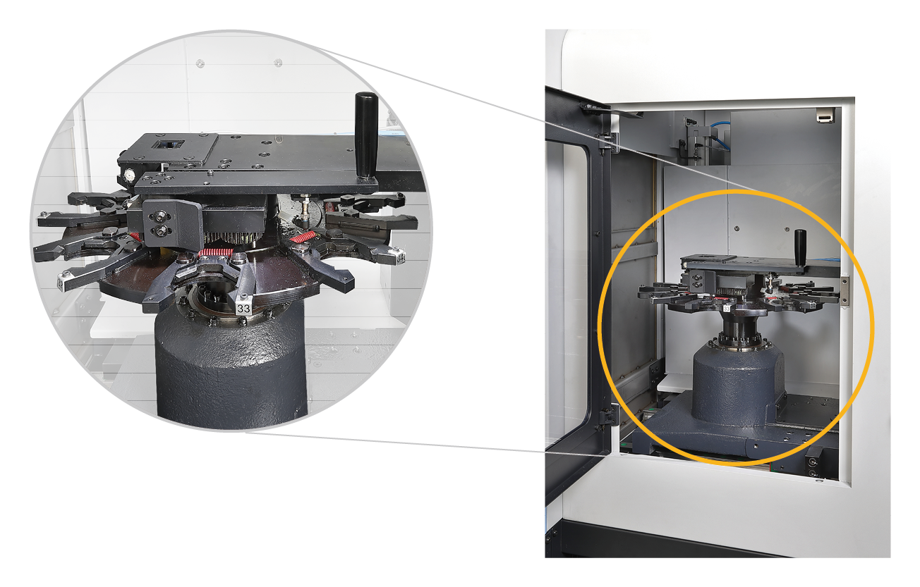

Automatic tool changer (option)

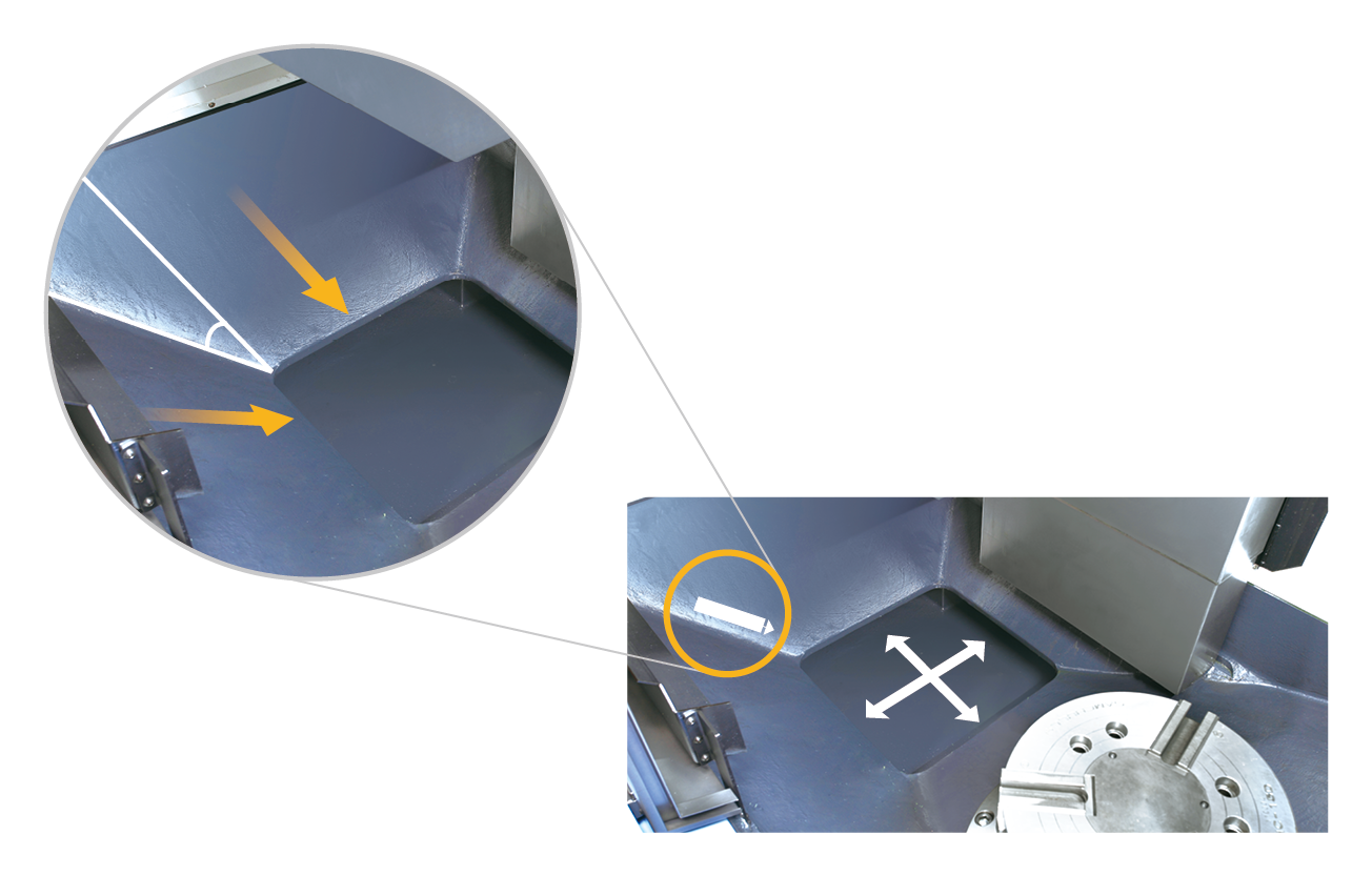

Improved convenience with smooth chip evacuation
Designed with a bed structure that facilitates chip evacuation, enhancing customer convenience

Automatic Tool Changer (ATC)
Automatic front and side doors
Robot interface prepared
Capto tool flushing applied as standard when ATC is selected
Tool monitoring system applied as standard
Improved magazine control panel design with additional internal lighting
