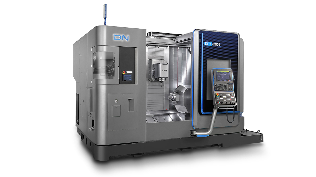

A compact multitasking machine capable of machining complex workpieces to perfection. With the largest machining area in its class and significantly enhanced convenience and productivity options, you can maximize your business productivity.
Multitasking Capability
Shorter Setting Time
Powerful Multitasking Machining Capabilities, Higher Productivity
The dual spindles (1st and 2nd), 0.0001° B-axis, milling spindle, and servo tailstock offer outstanding multitasking capabilities, making it perfect for machining intricate parts.
With an orthogonal structure, it offers the largest machining area in its class.
Benefit from a generous Y-axis stroke of 115mm for optimal use of your work space.
Reduce set-up times and increase productivity with our chain magazine for up to 60 tools.
New optional features are designed with convenience in mind.
Featuring a High-Power Built-in Spindle as Standard
Equipped with a built-in spindle with the highest output in its class
Increased precision with the highest clamping force in its category.
High-precision control of the B-axis in 0.0001° increments.
Powerful Options
Benefit from built-in tool breakage detection for early warnings and reduced downtime.
Equipped with an arm-type tool setter.
Enhanced space utilization and quality with the new parts catcher.
Available diverse controller (FANUC, SIEMENS)
Improved Convenience
7-inch ATC magazine screen allows for easy operation and monitoring.
Parts catcher (servo) with unloading position adjustment optimizes your production process.
Alarm recovery feature ensures minimal downtime and uninterrupted operation.
The chuck position sensor reduces process times and chuck changes, resulting in higher efficiency.
Software
Features DSSV (DN Solutions Spindle Speed Variation) as a standard feature for improved machining quality.
Easy-to-use machining cycles, such as Eccentric Turning.
