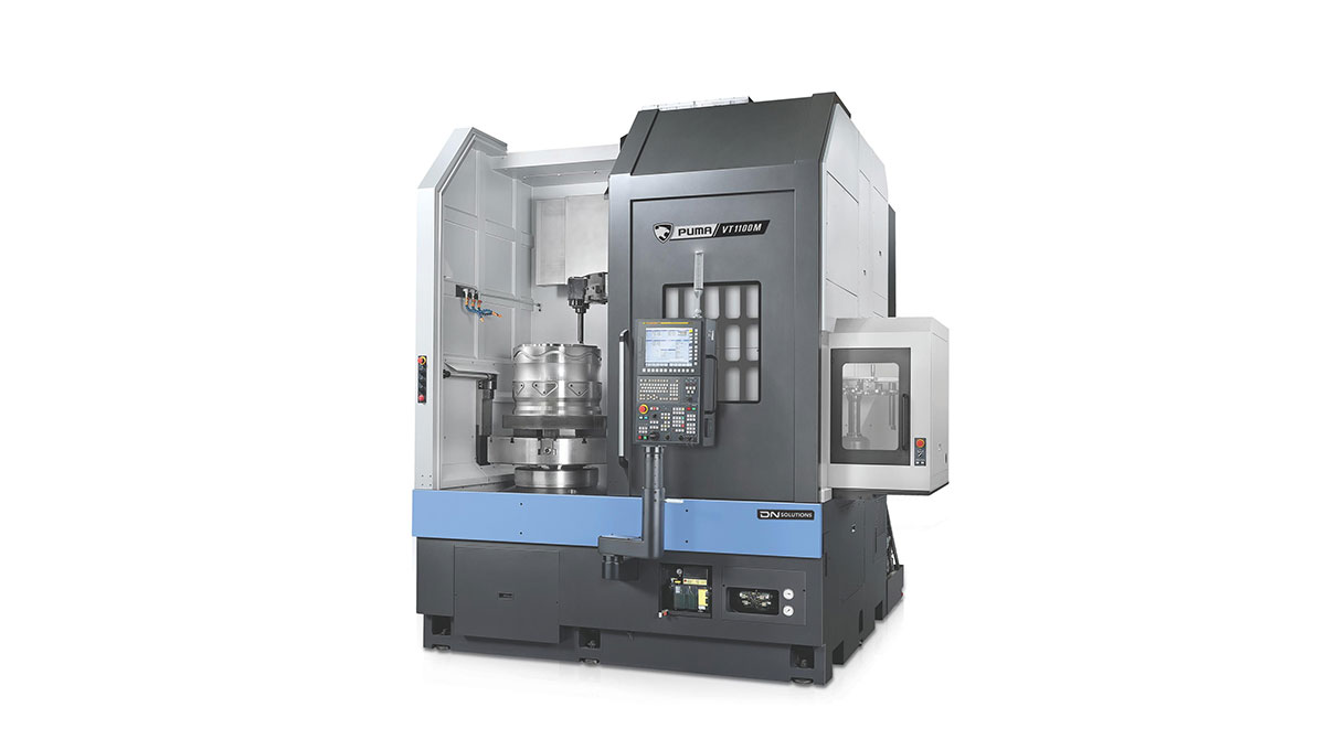

The PUMA VT1100 Series is a large vertical turning center that
￿ has the rigidity and spindle power to tackle the heaviest of heavy-duty work.
Convenient Tool Change
￿ Optimized for the heavy duty cutting of large workpieces￿
Chuck Size : 32 inch
60kW high-power spindle motor and high-end gear box
Max. Turning diameter x length : Ф1100 x 1000 mm
￿ Outstanding vibration absorption and a stable highly-rigid structure that enables long hours of heavy duty cutting￿
￿ ATC for higher productivity (option)￿
Tool shank : Capto C8
Tools storage capacity : 12 each
Max. Tool diameter x Length : 110 x 450 mm
No. of tool station Rotary Tool r/min
PUMA VT1100
32 inch 1100 mm 960 mm
20 m/min 20 m/min 580 mm 1000 mm
850 r/min 65 kW 7559 N·m
2830 mm 4012 mm 3305 mm 22000 kg
PUMA VT1100M
12 ea 3000 r/min
2830 mm 4012 mm 3305 mm 22550 kg
