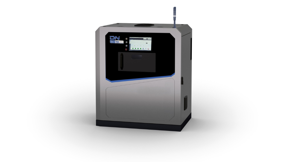

DLX 150
Φ150mm mm
195 mm
Number of Laser
1 ea
DLX series
DN Solutions Laser eXecution solution
High-performance PBF system with best-in-class working area, exchangeable build containers, and full DNS integration for machining, automation & software — max productivity, seamless workflow.

Build Size
Length Width Height
Laser
Type Number of Laser Power
Optical System
Type Focus Diameter
Gas Management
Filtration Retentate Protective Gas
DLX 150
1650 mm 2350 mm 1250 mm 1600 kg
Φ150mm 195 mm
Yb – Fiber Laser 1 ea 500W/1000W
2-axis 45-80 µm
Cartridge-type Argon/Nitrogen
DLX 325
4500 mm 2700 mm 3800 mm 4500 kg
325 mm 325 mm 420 mm
Yb – Fiber Laser 1/2/4 ea 500W/1000W
3-axis 80 µm
Permanent Chalk Argon/Nitrogen
DLX 450
4600 mm 2800 mm 4100 mm 5500 kg
450 mm 450 mm 470 mm
Yb – Fiber Laser 1/2/4  500W/1000W
3-axis 80 µm
