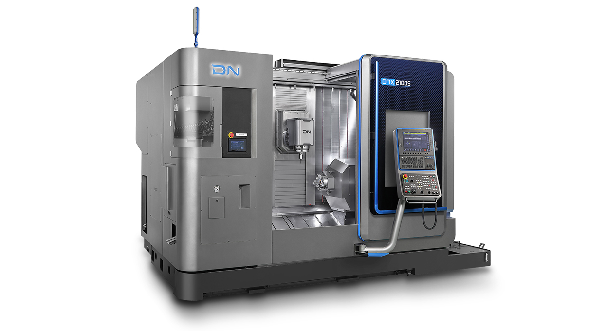

A compact multitasking machine capable of machining complex workpieces to perfection. With the largest machining area in its class and significantly enhanced convenience and productivity options, you can maximize your business productivity.
Multitasking Capability
Shorter Setting Time
Powerful Multitasking Machining Capabilities, Higher Productivity
The dual spindles (1st and 2nd), 0.0001° B-axis, milling spindle, and servo tailstock offer outstanding multitasking capabilities, making it perfect for machining intricate parts.
With an orthogonal structure, it offers the largest machining area in its class.
New optional features are designed with convenience in mind.
Featuring a High-Power Built-in Spindle as Standard
Equipped with a built-in spindle with the highest output in its class
Increased precision with the highest clamping force in its category.
High-precision control of the B-axis in 0.0001° increments.
Powerful Options
Increased productivity with a tool breakage detection device integrated within the magazine.
Equipped with an arm-type tool setter.
Enhanced space utilization and quality with the new parts catcher.
Improved Convenience
Equipped with a 7 inch ATC Magazine Screen as a standard feature.
Parts catcher (servo) with an unloading position setting feature.
Equipped with an alarm recovery function.
Adoption of a chuck position sensor reduces process and chuck replacement time.
