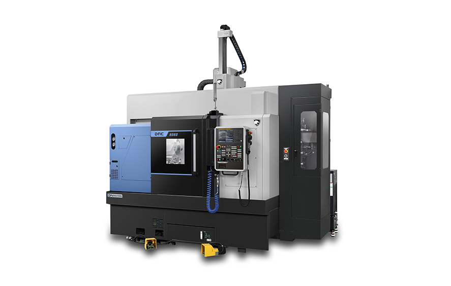

DNC 8060
810 mm
DNC series
Ceramic & Quartz Grinding machine
DNC seires are Horizontal Turning Center with Grinding and Machining function in one machine which is optimized for ceramic and quartz machining and easy for automation.
Shortened Machining Time
Easier Automation
￿ Excellent Machining Capability
￿ Various chucks equipable(12~20inch)￿
￿ Various option including Vacuum chuck or Built-in motor Available￿
￿ BP12/30 spindle motor￿
￿Hole machining and contouring available without machining center
￿ Premium quality grinding spindle
￿ designed by DN Solutions￿
￿ Max spindle speed 10000r/min, Max power 7.5kW￿
￿ BT40 Big plus and CAT40 Big plus Applicable￿
￿ Fanuc motor based DN Solutions in-house manufactured spindle ￿
￿ TSC option available￿
￿ Rigid machine structure
￿ & User friendly design￿
￿ Full cover structure for protecting the inside of the machine￿
￿ Easy cleaning coolant tank￿
￿ Servo motor equipped ATC(8 or 40 tools)
Auto tool inspection & Auto workpiece inspection applicable￿
Chuck size Max. Turning Diameter
Grinding Spindle
Max. Spindle speed Tool shank type
DNC 8060
12 inch 810 mm
10 m/min 20 m/min 550 mm 650 mm
2840 mm 2042 mm 2043 mm 3400 kg
10000 r/min BT40
